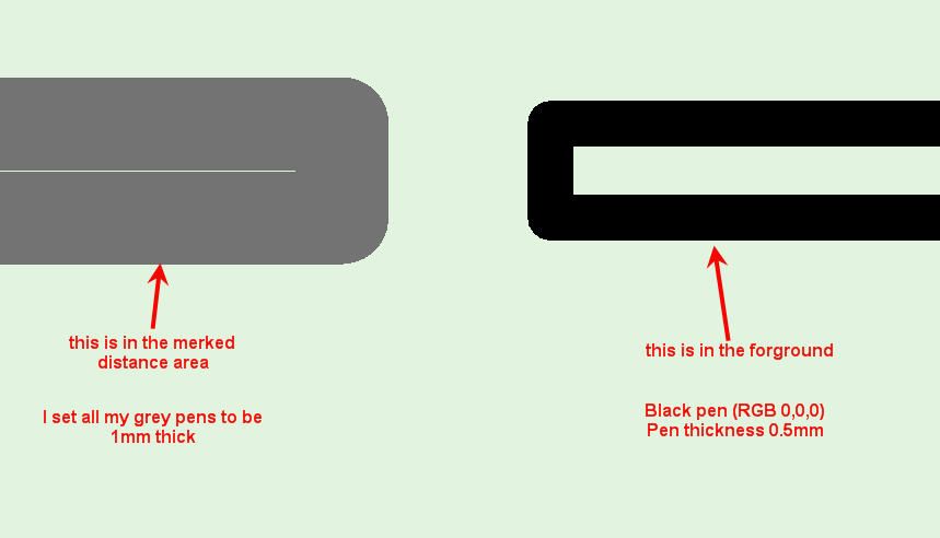

It seems to be looking for another pen that is the closest match to half of the RGB values of the outline pen.
Whatever thickness that pen is then that is what it uses.
So even if it is thicker than the original outline pen then your marked distance will be thicker and not thinner.
I just tried with a thick (0.5mm) black outline on the slab.
The marked distance was coming out grey.
So I reset all my grey pens to be thicker (1.0mm) and the marked distance area is now showing thicker than the original.
If you play around setting individual grey pen thicknesses you can figure out which pen it is using.
It doesn't actually just reduce the pen thickness and keep the same colour.
If you play around setting individual grey pen thicknesses you can figure out which pen it is using….
If you go to your layout and select the view in question, go to Drawing Selection Settings and click on "View Drawing's Own Pen Set" you can narrow it down more easily as it will only display pens used in that view.
I do like the way Renovation overrides change the colour but maintain the line weight. It would be nice if Distant Area option used a line weight relative to the original pen, rather than the line weight of the closest colour match it finds. Maybe half thickness and half colour depth?
