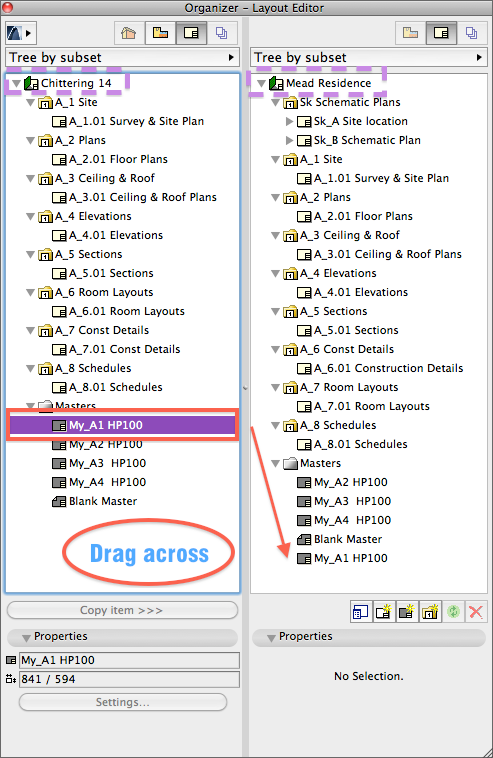

I have developed (and continue to modify) a collection of master layouts for my projects. I also have two or three project templates designed to suit different project types. I'd like to insert the collection of master layouts in each of these templates without having to create them again within each template. Is there some form of "copy/paste" that will permit me to copy a master layout and paste it into another layout?

Bob, open 2 instances of archiCAD then open the Organiser and drag the master layouts across.
See attached.

Just to add a little further info.
In the organiser click on the button top/left to load the layouts from the second (running) Archicad.
Or you can just "Browse" without opening a second Archicad.
If you have drawings in your masters they will still be linking to the drawings placed in the file you dragged from. So you will need to "Re-link" all drawings to internal views that you have set up in your current file.
