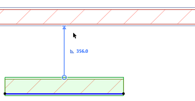

How can I use smart guide so it works with the core of a composite, nit the finish of a composite.  (ex: stud with gypsum board, I need the smart guide to show based on stud, not gyp. bd.) .   Another great feature that ArchiCAD did not take the rest of the way...... So many ways to make this program the best, but as always falling short.....Come on ARCHICAD!   Hopefully I am wrong in this case.   😞  I was excited to use this feature...

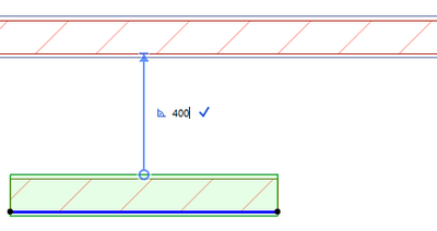

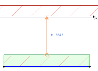

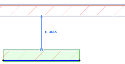

This is possible to do because you can temporary move the reference of the Distance Guide.
To do this, select the element you want to manipulate so the Distance Guides appear.

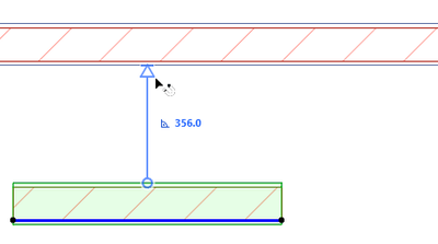

Now, move your cursor above the Arrowhead of the Distance Guide.
Notice that the Arrowhead becomes empty and it becomes slightly larger. Click on the Arrowhead, and this will enable you to temporarily set a new reference from which the Distance Guide is measured.
Click the Core boundary of the Wall (you may have to zoom in to make sure the Mercedes cursor finds the desired line) to set it as the new reference from which the Distance Guide distance is measured.

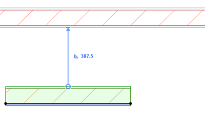

Now, type the new distance you want to move your element to. In this example, I typed 400 and pressed ENTER.
The element is moved. Note that the Distance Guide's reference now moves back to its default position (edge of whole element), which is why the Distance Guide displays a distance of 387.5, since the thickness of the finish is 12.5 and 387.5 + 12.5 = 400 mm, so .
Another thing you can try is to use the "Reference Lines" option of the Distance Guides so Distance Guides are measured from Reference Line to Reference Line, not from edge of element to edge of element.

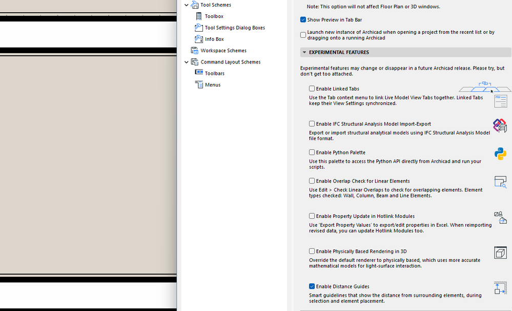

You guys could start a new Wish topic about how Distance Guide could be improved.
For example, it could react to Partial Structure setting changes, so in Core Only mode it would consider only Cores.
Or, like jl_lt says, there could be a keyboard shortcut (e.g.; TAB) that would cycle through all edges of a reference element.
All these could be collected in a Wish topic.
