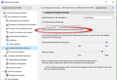

Sorry haven't replied. I noticed an improvement when I set up my preferred Work Environment and brought in some 3D styles from V24. Checking and unchecking the box for 3D Antialisng (Harware Accelerated mode) in the Advanced Redraw Options didn't do much to be honest.
I do definitely see a jaggered contour if I use the template 3D style settings over my own previous settings. The strange thing is if I match the settings of a 3D Style from v24 inside v25 it's not much help but if I import a v24 3D style it seems to help even though the exact same settings are ticked. Quite weird but it at least resolved it.

Check your Work Environment settings.
You need to turn on 3D Antialiasing.
