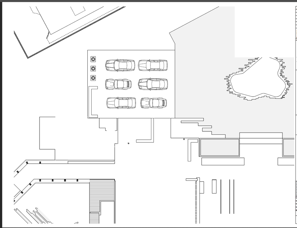

I've been having a big problem for a while with an specific Archicad file. We already reached out for Graphisoft support but they couldn't solve it either.
When I export my layouts to PDF and I open the PDF file on Adobe Acrobat, it shows a message: "There's an error in this page. Maybe Acrobat doesn't show the page correctly. Contact the person who created the PDF document to correct the problem". And all the pages are mostly empty, showing just some random lines and fills. The strange thing is that when I open the same file on Microsoft Edge, all the layouts look completly normal. I guess there's something in between Archicad conversion to pfd and Acrobat reading of the pdf file. I saw some comments here at Graphisoft community of people having the same problem, but none of them seem to come up with a solution that worked for me. I've already tried to print instead of exporting but there's no page size compatible with my layout size. I've also tried so many other things and nothing works.

No, my layouts are just plans of a house. So some walls, dont show, some objects, lines, fills, everything. And its not about the layers because some with the same layers show and some don't.

Can you post an example pdf? Maybe it is just an issue with acrobat on your computer, and a reinstall is necessary?

Thanks. I'm sending an example but it's not only on my computer, it's happening with the whole team. Only this specific project.

Maybe try to repair the project. When opening a project there is a checkbox you can mark that says "open and repair" and it can solve some issues. Other than that I don't know what to do except gradually remove objects and fills and stuff to try to find what is causing the issue. Might be some text as well, incompatible fonts?

We ended up deciding to start a new file from zero and I started copying the whole project and testing the pdf exportation. Then I discovered that some specific slabs that were corrupting the whole file. So I erased them and it finally worked! Thanks for your help though.
