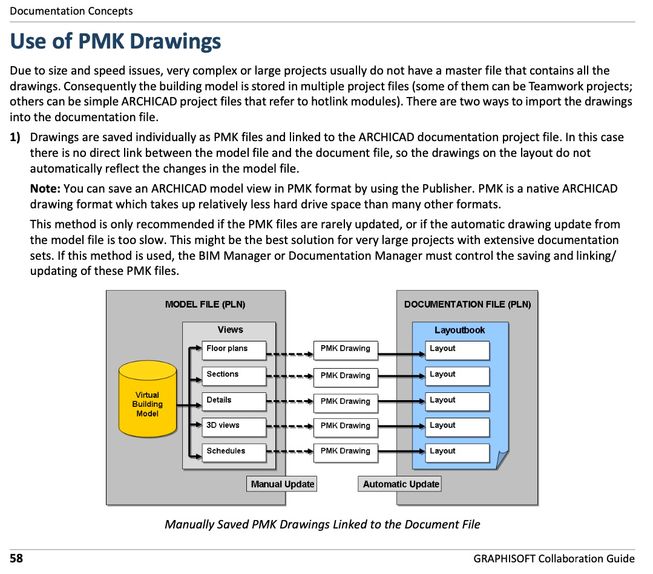

I´m wondering whether using pmk files is still relevant. ( I´ve found most of the post in here are way old)
Let´s say your project has grown big, and "slow" - updating layouts takes time...
Would it then make sence to switch to the pmk methodology, and what if you have 100+ layouts and 150+ active views.
If yes, then;
If one hasn´t prepared the project for this, then you would have to create a new project and setup all Layouts (again) and then link/load and arrange all pmk´s on new the new Layouts from scratch...
Or simply create a copy of the original project, and the delete the model, and the views, leaving only the layouts, and then link/load all the pmk´s into the new Layout-project
If the Project wasn´t prepared to facilitate the pmk method, would it then even make sence to start this process/workflow when you already did layout some 100+ Layouts in the original .pln?
Any tricks to automate the pmk linking process? - In an "empty" project you could browse for views in another project, then drag those onto the layout book of your current project, and have AC create Layouts and place external linked views on them, however they need to be properly arranged - Then one would have to relink the external views to external pmk files....
...Or is there any nice tricks to automate the process, if you want to go with pmk´s after the entire project has been set-up in a main .pln with both model, views and all the layouts?

Archicad used to be delivered with a PDF manual called the "Collaboration Guide" in the Archicad xx > Documentation folder.  As far as I can tell, the last time this guide was published and delivered was with Archicad 21.  The Archicad 20 version (2016) is the only one I found via Google:
http://helpcenter.graphisoft.com/wp-content/uploads/2016/06/Collaboration-Guide-for-ARCHICAD-20.pdf
There was also a more recent document on either the Graphisoft Learn portal or the SSA subscriber content portal that described this same process in detail.  I can't find either of those at the moment.
A couple of screenshots of the first 2 pages of the PMK part of the Collaboration Guide:
