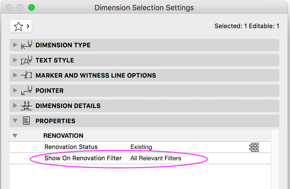

Thanks. How do you pin to a renovation set?
AC26
https://www.zendsign.fr/
JaseBee
you can do this for almost any element in Archicad, but if you do then it's only ever visible on that renovation filter, nowhere else.
