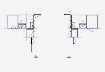

Does anyone know a fix for the following?
I made a label that attaches to a Revit (.RVT) module file that makes a opening line for the door, it retrieves its width from the door width which is embedded in the revit properties. However, when I mirror the module, the label also rotates, does anyone know how to previt this?
The module on the right side, is the correct one

I fixed it, adding this will make it work:
IF SYMB_MIRRORED THEN
 MUL2 -1,1
 ROT2 180
ENDIF
