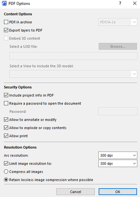

Hi, have you tried pdf options in archicad? Also, could be too much fills honestly...

Hi Mija,
 Thanks for the quick reply! I've just tried the PDF document options, thinking that if I didn't export layers, it may help. Sadly it hasn't made a difference.
