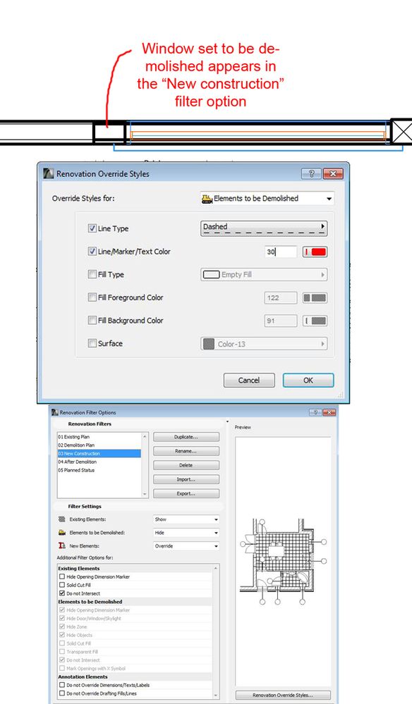

Hello -
Issue:
Window set to "To Be Demolished" is appearing up in the "New Construction" renovation filter.
Things checked:
- Renovation Filter shows elements to be demolished are set to "Hide". New elements are set to "override."
- Renovation Override styles doesn't appear to show anything that would cause the window to still show on the New Construction status.
- Looked at Model view options and didn't see anything that would pertain to the demolished window to appear on the new status.
Something I'm missing obviously, but can't put my finger on it. Attaching screenshots of renovation filter options and override styles.
Thanks for the suggestions in advance.
