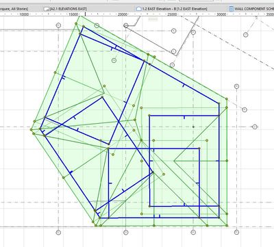

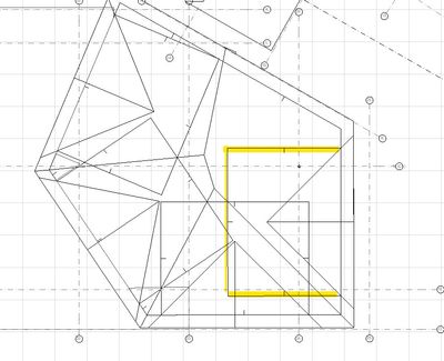

How do I hide the "blue" lines, the ones marked in yellow in the second image in plan?

View > On-Screen View Options > Roof Pivot Lines

It looks like they are just the reference lines and will not show when printed.

The roof pivot lines will not print and you can turn them off as mentioned.
They still will show when you select a roof though, because it may be something you want to edit.
