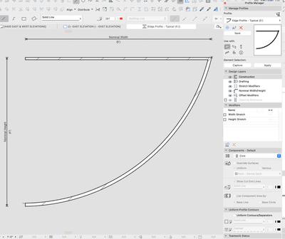

Screenshots explain all. A round profile doesn’t show properly on elevations. See the shadow. If anybody knows a way to fix this please let me know.

That is correct.
There is no such thing as a smooth curve in Archicad.
It will always be faceted.

2023-09-01 10:07 AM
Objects have RESOL or TOLER command that you can set.
But there is nothing for complex profiles.
It is based on a built in algorithm to do with the radius of the curve I believe.
I think there may be a setting in the registry keys (Windows OS bit there is similar on a Mac).
But that is a bad idea to play with them, as it will only affect your machine and that particular version or Archicad.
You need to make the same setting on every machine and for every version of Archicad that will open that file.
