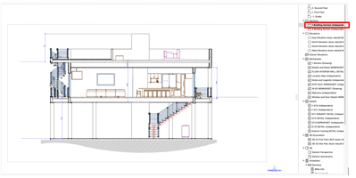

Hi the story levels have randomly stopped showing in my section model views. I am not sure how this happened. Both in the section settings and the story settings the levels are checked.

Thanks , the section markers are still there. And the status is set to auto rebuild model. But could it be because I linked the section marker to a worksheet? But that doesn't explain why the section shows just lines and fills when its set to auto rebuild model.

In the view you posted
the "Building Section (Independent" text is BOLD
this tells me that is the view you are in when you took the screen grab.
Because its not a "source" view,  the level markers will not appear.
How does it know how wide the section cut is? it puts the level markers at the outer edge of the cut.
no source view, no section width, no level markers.
if you add 3D content to your model and this view does not automatically update with the new 3D content then it is not set to "Auto-Rebuild Model".
i don't know how to fix this without changing the marker back to a "Source" section marker, and relink it to the section viewport.
the name will change back to (Auto-Rebuild Model), not (Independent)

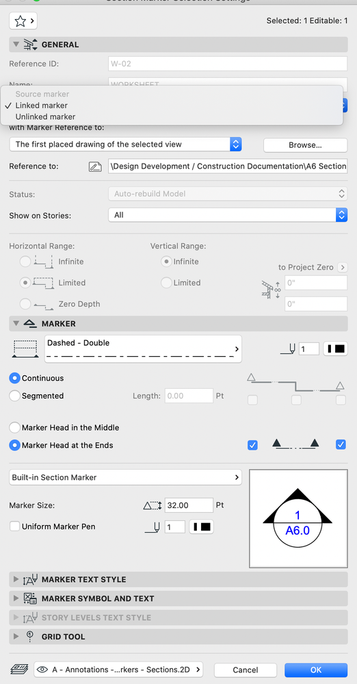

Thanks Allan - the marker is a linked marker so maybe that is why. The section is also 2D lines and not model 3D objects. When I go to change the marker type to source however it is greyed out. I am not sure why I cannot change it

Solution
The marker has to be linked to its original section window to be able to be changed back to a source marker.
you change the marker to "unlinked".
you change the marker to "linked" selecting the original section window in the Project Map list
you can now make it source marker again.
sometimes its quicker and easier to add a new section to the model and delete the old one if not too much documentation has been done in the window.

Thanks! I was able to fix it
