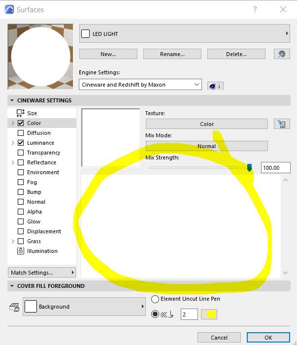

Hi there.
Trying to make a custom surface and as you can see adjustments are not showing up.  When i first launch Archicad 25 custom surface adjustments are visible  but when I go back into custom surface to fine tune custom surface adjustments do not  show up.  I've also opened existing program surfaces and adjustment don't show up.
Any help would be appreciated

Can you expand the Color category on the left side?

Thanks for your help.  I updated graphic card but didn't solve issue.  Issue was resolved when i followed direction to expand color category on the left.
I believe you can also click on the icon just to the right of the Color option in the main dialogue to go to the relevant page.
