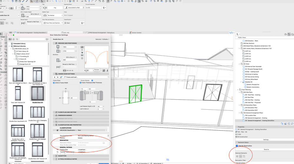

I am relearning Archicad after a long hiatus. It's been going very well and the answers I've needed on this forum and on YouTube have been great. However....
I have a stair and I can not change its renovation status from existing to demolition. What am I doing wrong?
I've created a new stairs on both with both demolition and proposed to test this, but then can't change those either. I'm working in Archicad 22 on a Mac

Is the option not available to you?

Hi Barry
No, the options are greyed out

I very rarely use renovation filters.
What would cause it to be greyed out I wonder?
Is this a teamwork file or a stand alone PLN?

Bumping this up - I'm facing the same issue with some doors.
The renovation status bar in the settings were all greyed out too..

As I asked the original poster - Is this a teamwork file or a stand alone PLN?
As a stand-alone PLN I can't think of anything that locks the renovation status.
I don't use teamwork so I can't check if it is a permission thing.
Can you access the Renovation Filter Options dialogue OK and make changes there?

Hi Barry,
Thanks for your reply.
The file is on teamwork - but I have reserved the element so it shouldn't be a permission thing. I have been using renovation status and it has been working - just some elements from time to time that I couldn't change or edit the status..
The Reno filter option dialogue also showed greyed too...

Is changing it via the Renovation Palette disabled too?
Would appear that changing a single element within an existing stair to new does not change the overall renovation status.... In 22 anyway.

Hi Ling,
Yeah both palette and settings are greyed out.
I can reserve, delete and create another door on the same wall but all fo them seemed to be greyed out..

What's the Renovation Status of the wall?
