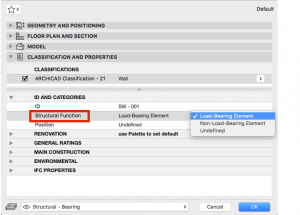

You can set the structural function of all model elements in their Settings dialogue under the Categories and Properties tab:

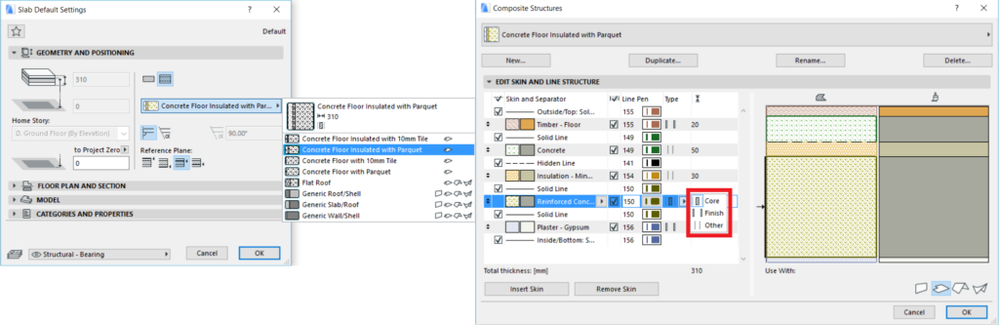

The Partial Structure Display settings define how composite and complex structures appear. Walls, Slabs, Roofs and Shells can be defined as composite structures. Composites can be created and managed in Options/ Element Attributes/ Composites.

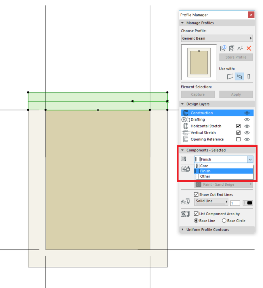

Walls, Beams and Columns can have a Complex Profile structure as well. Complex Profiles can be created and managed in Profile Manager in Options/ Element Attributes/ Profile Manager .
The load-bearing skin of a composite or complex structure is called the Core. Skins can be defined as Core, Finish or Other. Partial Structure Display affects the display of elements in 2D and 3D windows alike, and it can be assigned to the following window types:

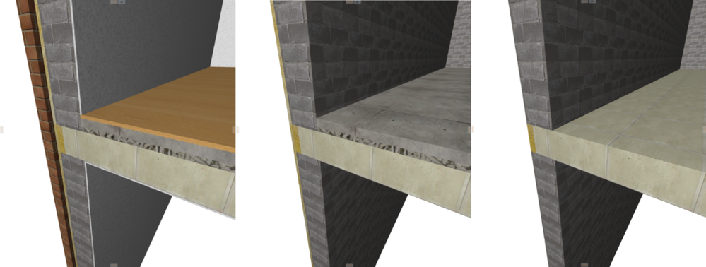

The Partial Structure Display setting is saved with the view. The following figures are examples of Partial Structure Display settings applied for different views.
Sections
entire model > without finishes > core only
3D View
entire model > core only

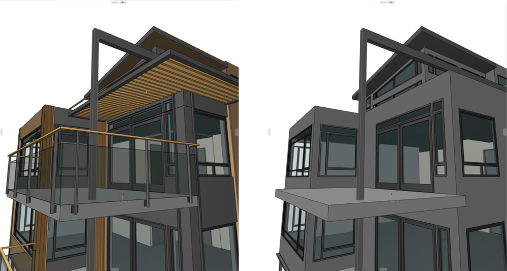

What I am looking for though, is a way to show the structure as Archicad would in "Core Only" setting, but still show all the rest of the complex profile skins, but in a thinner, lighter pen for the structural and framing drawings.
For the general architectural plans I still need to show all the skins in a normal display.
The 2 examples done in Revit is what I'm trying to achieve in Archicad.
The only way I can think of right now of how this may be achieved is by defining two Pen Sets and achieving the desired line thicknesses by those two Pen Sets.
