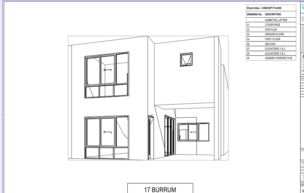

The drawings pen sets is set to 'original colours'.
I am working from a brand new V20 template so I haven't messed up any settings that could be causing it.
Is this a V20 glitch? And if so, I really hope they fix it soon....

Hi laszlonagy, thanks for your reply.
I already have those settings correct and it makes no difference. The strange thing is that the 3d view on the layout changes from black & white to colour back to black & white again at random. When the computer has been asleep and I start it up the next day and open up the ArchiCAD file (it wasn't closed down, just minimised) the 3d image will change.
It is totally frustrating and I'd love to hear if others are having the same problem and what solution they may have been given by their software distributor.
