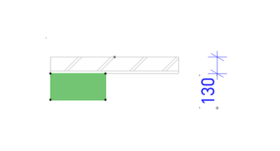

I will add fills to the annotation part of a wall schedule as "new" but when I save it, it will change to existing. Is this a bug? or have I clicked something?

Here are some screenshots of what's happening:
  • I would add a fill (renovation filter is new) in the annotation view Annotation view - adding a fill.PNG
  • Save changes and exit annotation view -  this is what it looks like in the schedule Save view - it appears grey (existing).PNG
  • Click back into annotation view and the fill is now on an existing renovation filter. Annotation view after - the fill is existing.PNG
I would try to change it to new again but when I exit the annotation view it would change back to existing itself.

Hello,
Thank you very much for sharing your problem with the annotation in Schedules.
As far as I know, this is a limitation of the annotation elements. At the moment, we can't assign a renovation status to the annotation. Our development team is aware of this issue, however fixing this would bring many design questions, so it's not an easy one to implement,
I hope this answers your question. Please let me know if you have any further issues!

Hi Minh,
Yes, please the design team know that this issue is quite frustrating.
I don't need to be able to assign renovation filters to the annotation elements, just for it to not revert to something that I haven't drawn it as. The only work around I have been able to do is to draw fills on top of the schedule on the layout.
Please let me know if there's anything I can do to stop the fills from reverting to an existing renovation filter so I don't need to draw fills that might jump when the schedule changes (more error for mistakes!).
