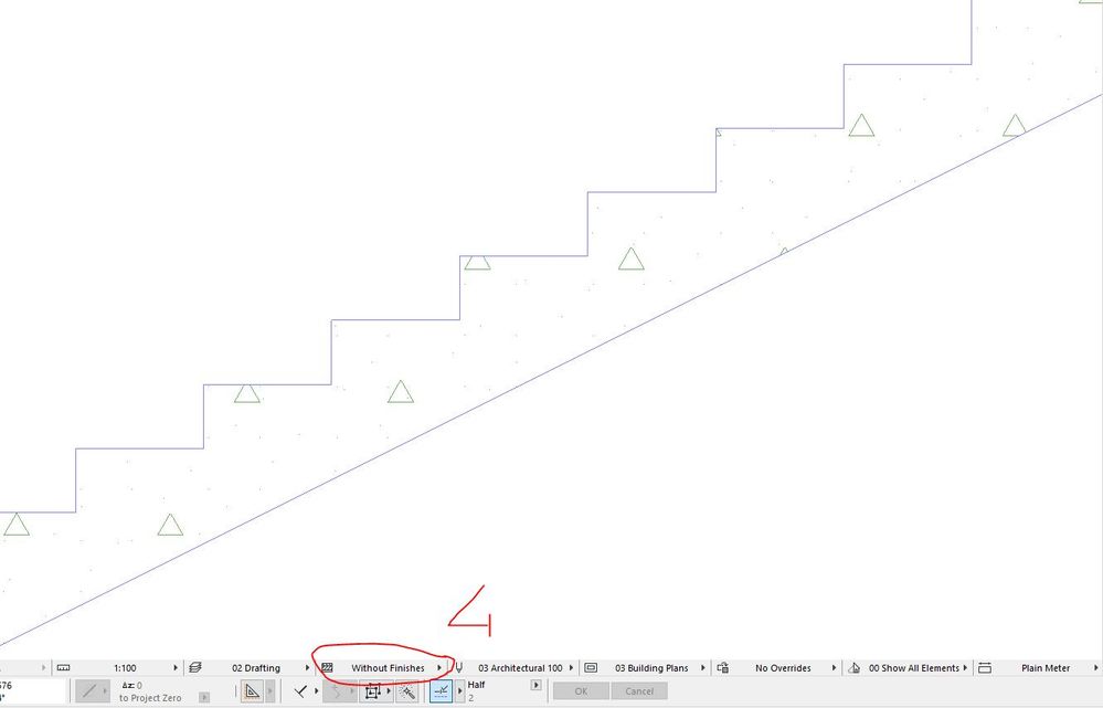

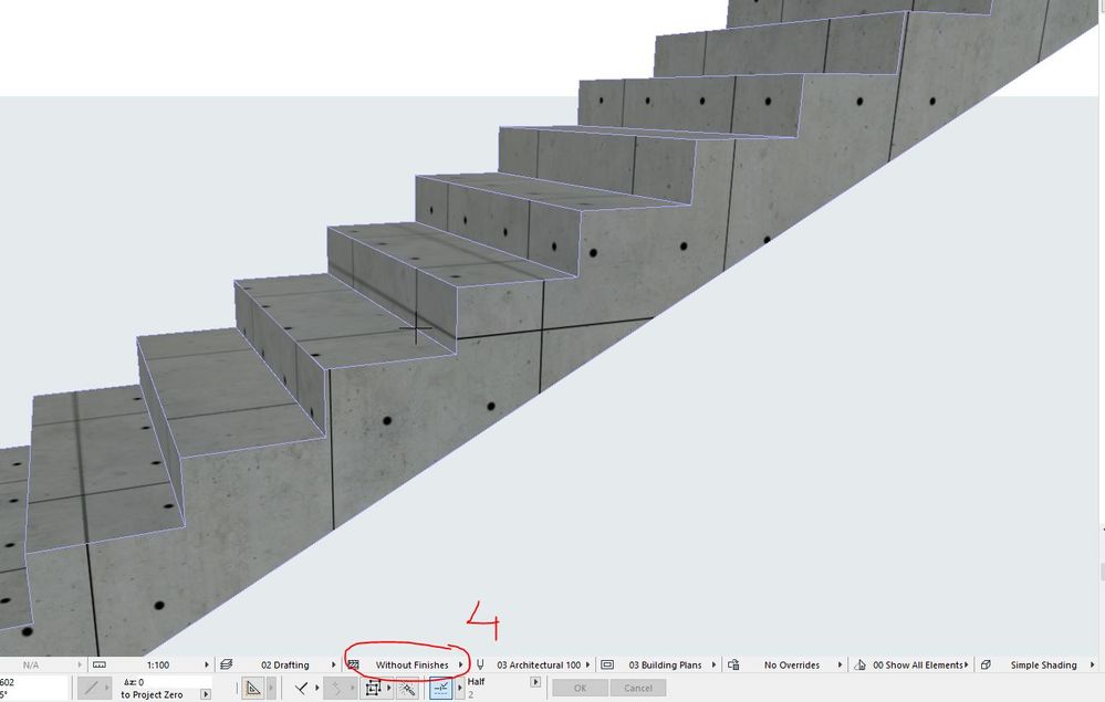

2022-06-13 03:38 PM
You have to select Profile Tread 25 in dialog settings and then apply your profile:
Step 1 and step 2
Then select "finish" for your component:
Step 3
and then select display "without finishes" in Partial Structure Display.
But as I mentioned above, it only works for 2D Sections and for 3D views, but doesn't works for 2D plans:
AC 8.1 - 27 INT/POL 3001
Win11 | Ryzen 5600 | 16 GB | GTX 1650

2022-06-13 03:42 PM - edited 2022-06-13 03:46 PM
But remember, when you select "Without finishes", all components that have a "finish" marker in the project will disappear. So it is a solution for some simply cases only.
