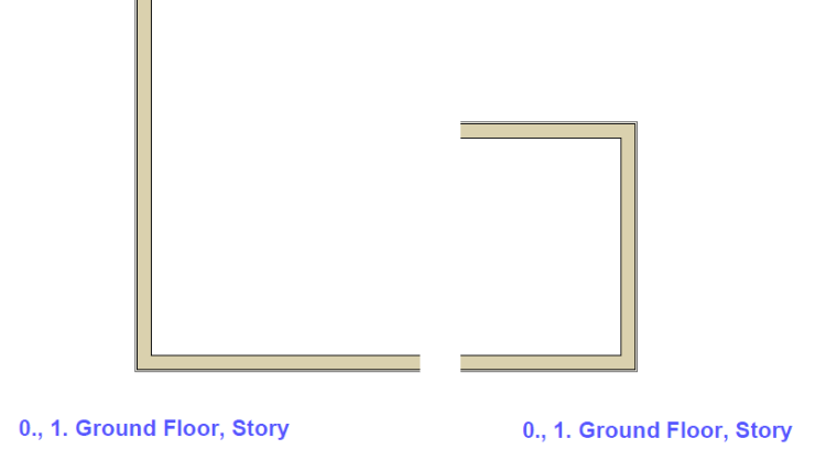

We have discovered a regression issue with Archicad 25 Update 500x.
Issue:
After exporting to PDF or other 2D formats, the autotext in a custom drawing title will show the content of all drawings in a layout if the layout contains more than one drawing.
Drawing title in Archicad
Drawing title in PDF output
Solution:
We have released a hotfix for Archicad 25 INT, AUS, USA, NZE, UKI, AUT, CHE, GER, FRA, ITA, NED, and Archicad 25 Solo INT, UKI, USA language versions. Updates for other language versions will be recreated to include the fix.
