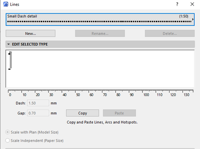

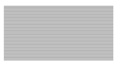

I came across an article by @Hmooslechner that asked to not have rounded corners on a thick line created in Archicad. (https://community.graphisoft.com/t5/Modeling/Rounded-corners-when-using-thick-lines/m-p/337755#M1588...)
Then I came out with a workaround with a symbol line that allows to have a pattern that is repeated. This is valid only in a dashed line solution.
by drawing parallel lines that make part of a "dash" we can then copy it and Make a symbol line out of it.
This copied element can make part of a dashed line that can have various gaps and dash sizes according to the required representation.
Hope it solves other users issues...
Cheers
