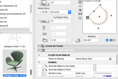

not sure what happened…it was showing the form of this designer chair on floor plan and then it changed to this simple form. how do I change it?

2021-12-28 10:32 PM
Thank you Laszlo...
I just figured it out by changing the scale sensitive to 1:50 and it is showing the form.

2021-12-28 10:31 PM
Maybe the chair has a setting to set its 2D representation based on MVO settings and you changed the MVo settings for Objects to a simpler representation. This could be done by activating a View, since MVO settings are saved with Views and applied when a saved View is restored.

2021-12-28 11:49 PM
any time it's set to "by MVO", it is going to be controlled by the model view option settings... which are prone to buggy hiccups
