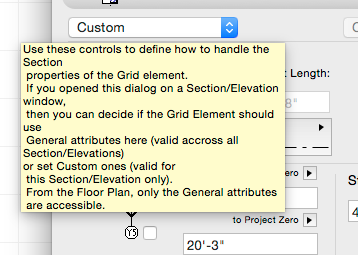

Just one more thing- and I apologize if I'm not understanding something- if I open one of my elevation views in my view map, select the grid and open the tool, and hover over the 'custom' setting, I receive the attached message (see below). This is what led me to believe that I could control the hgt. of the column bubble in different views.

Oops, sorry, I misunderstood your question.
So yes, when you select the Custom option, you can define the settings for the Grid Element individually in each Viewpoint.
What you need to do is select the Interior Elevation, go to its Settings Dialog, and check the "Show Grid Elements' checkbox in its Grid Tool panel.
This checkbox by default is checked for Sections and Elevations, but unchecked for Interior Elevations.

This does not appear to be working in AC18 6000. We are unable to create Custom settings for grid elements in sections or elevations. I've tried altering this from both the project map and the view map. I've also tested with grid elements placed separately as well as using the grid system. Also tried graphic editing of individual grids in a section window. The changes made in one window are inherited by the others.
Same result. Not as suggested by the hint bubble.
Did this work and get broken? or is the hint bubble in the previous comment false?

Yes, this seems like a bug. This is how it is supposed to work:
http://helpcenter.graphisoft.com/guides/archicad-18-int-reference-guide/user-interface-reference/too...
However, I can confirm that this Custom setting is currently not working in AC19 either.
Also the other field, the Copy from field in the upper right corner of the panel does not work either.
I will report this to Graphisoft.

The Grid Tool is still not working in elevation/ sections in ArchiCAD 21. The grid line offsets jump around and overlap and the custom features don't work.
If I adjust the grid offsets to not overlap in one elevation then go an look at the opposite elevation they are all flipped around. Why aren't they mirrors of each other. Four generations of ArchiCAD later....Is their a fix for this yet?
