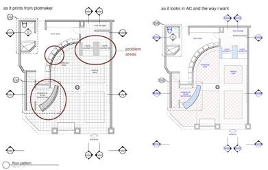

Three q's that I have not been able to fix and need help:
1) when i link views or pmks from AC to PM the fills even though solid become transparent showing elements that i don't need.
2) On update from linked views PM hangs up and freezes requiring that i shut down the comp, since force quit does not work.
3) title names from linked views using <drawingname> display correctly (no .pmk ext) but since i cant use the link views and i am using pmk's then i get the .pmk extension on the title. Is there a way to get rid of it without exploding the title and editing the text. ( I have tried publishing from AC without the extensions and setting OS X to not show them but they always appear.)
Check the fill background setting in ArchiCAD; check the fill setting in PlotMaker - by default it is on Bitmap, I usually switch it to Keep original settings (see attached).
Does it print correctly form ArchiCAD?

It prints perfectly from AC. In PM what i get is what i see. I am running 8.1.0v1 (1410) and PM 3.1.0 (1410).

Eduardo Rolon
Changed the settings in PM and now it prints the same as in AC.
Thanks
