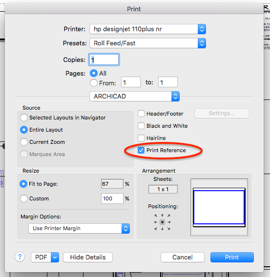

Stress Co_
It works for me now... with one small caveat.
The trace reference drawing is hidden by coverfills on the layout drawing.
The "make fills & zones transparent" button (on the Trace palette) is for display only.

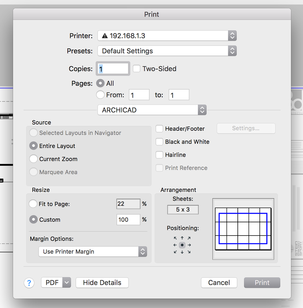

Marc, that "print reference" checkbox is grayed out for me for some reason.

Stress Co_
Double check that your trace reference is active.
Otherwise... I can't think why.

Dave Brach
yes, that was it, so I got it to work. thanks! however in the print dialog box, in the "arrangement" secction, mine shows sheets 5x3, and it is printing a 3' x 2' layout on what looks like 15 separate 8.5" x 11" sheets. any idea how to change that?

Stress Co_
You need to change your paper size in "Page Setup".
