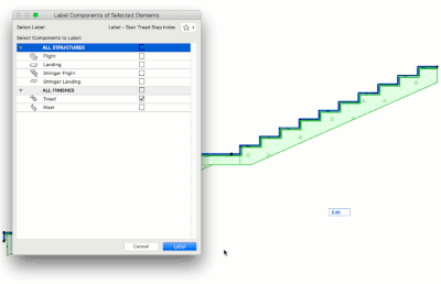

Stair flight numbers in section
There are two ways to label stairs in a section: manually (one by one) or automatically. The manual way is to use the Label Tool, find the Stair Riser Step Index and Stair Tread Step Index from the favorites, which are included in the default Archica...
wp-content_uploads_2018_08_man_label.gif wp-content_uploads_2018_08_automatic_label.gif

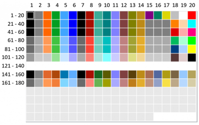

Pen Sets
NOTE: the available Pen Sets and their parameters can be different in every language version. In this case, this PEN SET theory doesn't apply to the U.S. version The Pens and Colors Settings Dialog is available in Options > Element Attributes > Pens ...
Info_18x18.png wp-content_uploads_2017_11_Pen-Set-table.png wp-content_uploads_archicadwiki_pen-sets--built-in_pensets.png wp-content_uploads_2017_11_columns-and-rows-1024x646.png

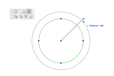

Create a Copy When Stretching Circles
User interactions should behave consistently and with expected results The behavior of the radial stretch command for curved elements, for versions previous to Archciad 26, could be more consistent. It left a gap in the user’s workflow when working w...

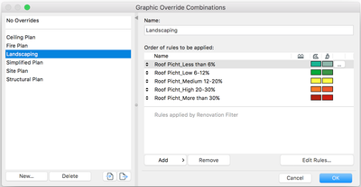

Easier Management of Graphic Override Combinations
Find and add a rule to a combination When creating Graphic Override Combinations, it can be time-consuming to find and add only one rule at a time to a combination. Now you can perform tasks faster — Graphic Override Combinations let you add multiple...
GabrielDantas_0-1653304822537.png GabrielDantas_1-1653304822540.png GabrielDantas_2-1653304822542.png GabrielDantas_3-1653304822544.png

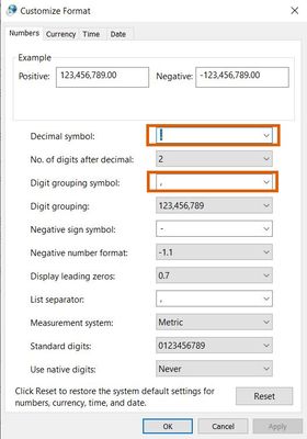

Decimals and Digit Grouping
Ever wanted to change how the numbers appear in Archicad, but could not find the settings in the Dimension Preferences? By default all numbers are showing commas for digit grouping and full stops for decimals. This can be very easily changed in the s...

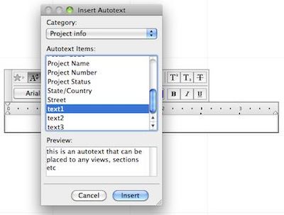

Autotext Annotation
See also: How to Insert Autotext in ARCHICAD Help. The ProjectInfo database can be used as a location for stored annotations. These annotations can be then inserted into the project with AutoText. If you work on a plan where the annotations belongs t...
wp-content_uploads_archicadwiki_autotextannotation--01.jpg wp-content_uploads_archicadwiki_autotextannotation--2.jpg wp-content_uploads_archicadwiki_autotextannotation--3.jpg wp-content_uploads_archicadwiki_autotextannotation--4.jpg

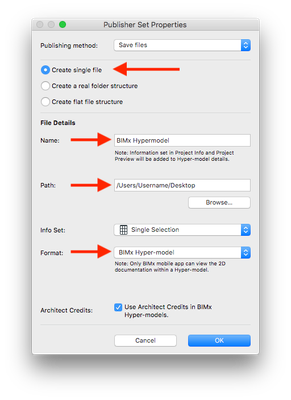

How Do I Set the Path for Publishing Only One Layout
In order to set up the path for only one layout, you have to set the path for the whole set, because the publishing path can be defined only on the level of the sets. To accomplish this there are two ways: The first way: Go to the Publisher Sets in t...
wp-content_uploads_2019_04_Publisher_set__1.jpg wp-content_uploads_2019_04_Publisher_set__2.jpg wp-content_uploads_2019_06_no-path-defined-300x132.png

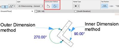

How to place Angle Dimensions in ARCHICAD
The Angle Dimension tool can be found in the toolbox palette, under the “More” group of tools: Angle Dimensions display angle values: between a pair of lines or linear edges or the angle of a curved element NOTE: Angle dimensions are not available in...
wp-content_uploads_2018_06_Capture-129x300.jpg wp-content_uploads_2016_06_Info_18x18.png wp-content_uploads_2018_06_possible-units-234x300.jpg wp-content_uploads_2018_06_methods.jpg

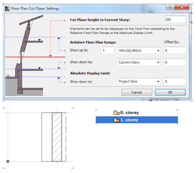

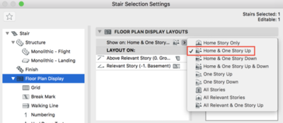

Floor Plan Display with Overhead
ARCHICAD construction elements on a floor plan usually can have 3 different displays. projection projection with overhead cut only Using Projection with overhead is a similar look for different element types: There are a few exceptions though, having...
Line types displayed across stories
In case we would like to show our elements on other stories as well, one might wonder where to set the line type for the display one story above or below? In case of three basic elements, slabs, objects and meshes, we can set this under Project Prefe...
wp-content_uploads_2018_05_Screen-Shot-2018-05-29-at-16.17.46.png wp-content_uploads_2018_05_Screen-Shot-2018-05-29-at-16.16.34.png

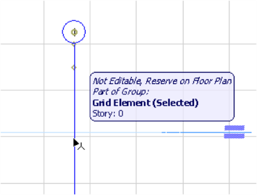

Grid Elements in Elevation or Section
The Grid Tool in ARCHICAD allows elements placed in plan view to show in Elevation and Section. Enabling Grid Elements in Elevation or Section Select the elevation or section in the project map and click the settings button. In the Elevation/Section ...
wp-content_uploads_2018_12_Screen-Shot-2018-12-18-at-11.04.34-AM.png wp-content_uploads_2018_12_Screen-Shot-2018-12-18-at-10.52.46-AM.png

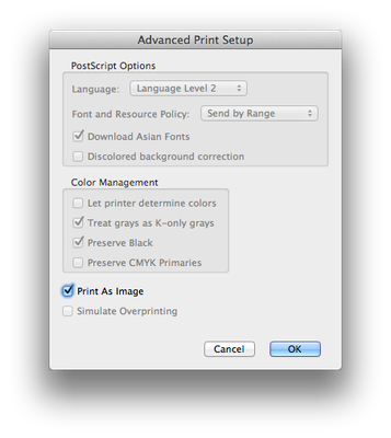

Printing problem with transparent fills
Issue Fills are not printed correctly via the File-Print menu or from printing via the Publisher Dialogue box. Some part of the fills are missing, see examples: Cause When transparent solid fills (also known as "percentage fills") overlay other fills...
wp-content_uploads_archicadwiki_bugs-printingproblemwithtransparentfills--vegleges001.jpg wp-content_uploads_archicadwiki_bugs-printingproblemwithtransparentfills--vegleges003.jpg wp-content_uploads_archicadwiki_bugs-printingproblemwithtransparentfills--3.jpg

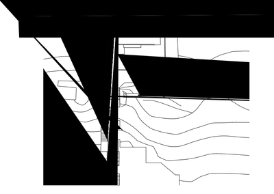

Entire Schedule/Index appears as solid colour in Layout
Affected version(s): 20 | Severity: workaround applicable | ID: 224455 Issue In certain cases, placed Schedule/Index on Layout appears as solid colour. Cause The issue occurs if Background Pen of the Fill tool is set to RGB colour (Colour of schedule...
wp-content_uploads_2017_03_issue-243x300.jpg wp-content_uploads_2017_03_cause.jpg

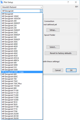

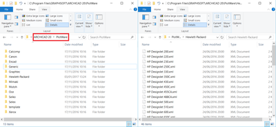

Creating Custom Plotter Drivers
Introduction There is a large number of .xml files called plotter drivers shipped with ARCHICAD. They are located in a folder named PlotWare within the main folder of ARCHICAD. These files contain some basic information (e.g. maximum paper size, size...
wp-content_uploads_2017_01_folder-1024x471.png wp-content_uploads_2017_01_plot-setup-681x1024.png wp-content_uploads_2017_01_text-file-968x1024.png wp-content_uploads_2016_06_Info_18x18.png

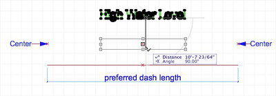

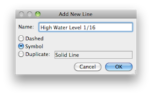

How to Create Custom Line Types
Create Symbol Line Type In our special example we are demonstrating how to create line types with letters in it, but the described steps can be applied to any custom line type. When creating custom line types, the stencil of the symbol may be drawn o...
wp-content_uploads_archicadwiki_customlinetypes--1.jpg wp-content_uploads_archicadwiki_customlinetypes--3.jpg wp-content_uploads_archicadwiki_customlinetypes--5.jpg wp-content_uploads_archicadwiki_customlinetypes--open.png

How to make Curved Text in Archicad
The article is based on Dan Kunschik’s original post on ARCHICAD-Talk and has been updated for ARCHICAD 15. Summary of steps To create a curved text in ARCHICAD, a few tricks need to be employed. Text (created with the TextTool) can not be curved, so...

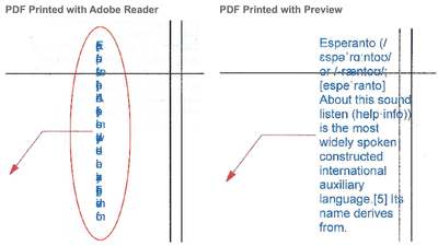

PDF file size and Fill choice
Files saved from ARCHICAD in 2D formats (PDF, DWG, DWF...) can be unusually large because of fill and line types used in the drawing. "symbol" type fills and "symbol" type lines explode in DWG and PDF - one line in archicad can break up to thousands ...
