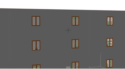

walls in 3d showing a line in between
k101

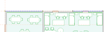

I mainly did one room and duplicated it many times so i ended up with not a single wall in the same line
and it shows in the 3d view 2 parralle line in the place where each "wall" stops...
Any help with that please?

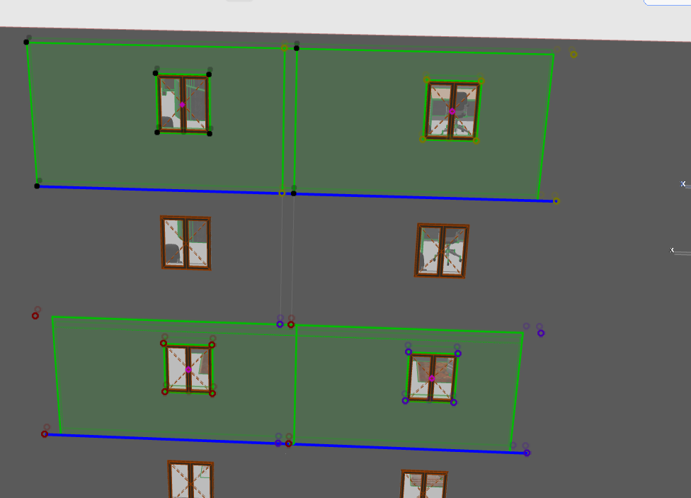

Pretty sure those are cause by the wall junction order. Can you try selecting your interior wall and reducing it's Intersection Priority?

it's Archicad 22 image_2022-04-27_115007017.pngthe one on the buttom don't have that problem but the ones at the top do show a double line like the non selected one right under it and it appears from all angles...

Looks like your walls overlap... instead of terminating at the same point, which your internal wall would also terminate at.
