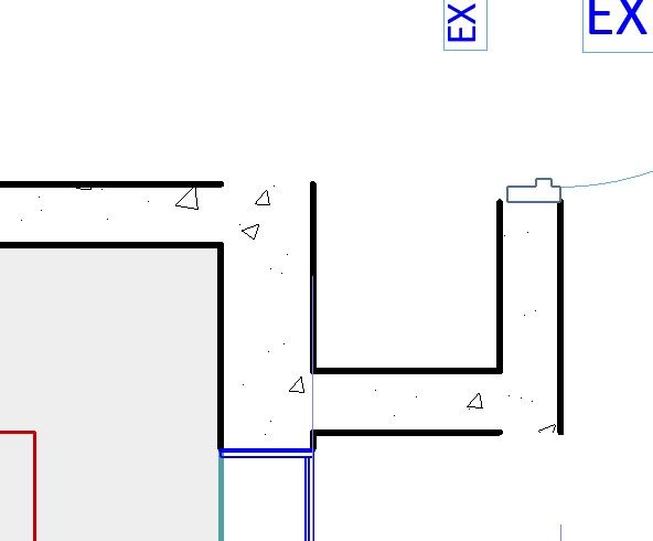

I've reviewed all of the same topics here but none of the remedies worked for me.  I can't get two of the same walls to connect with a solid line at the perimeter.  It's driving me crazy, help!

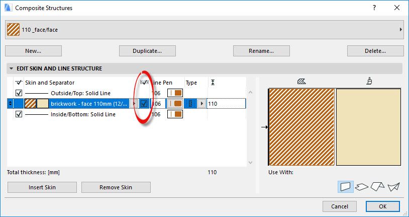

It has been discussed here a few times, but it is a matter of finding the correct post.
What you need to do is turn on the end lines of the skin in the complex profile settings.

Solution
Rajesh Patil
Try this, Select required  walls and check if there both ends are displayed in "display wall ends" settings in 2D plan section  rollout in "Wall Selection Settings" dialog.

That setting will only affect the free standing wall end.
It won't affect the corner connections or the door/window opening edges.
Rajesh Patil
And how about the wall reference lines, are they intersecting in required manner? Also by looking at the screen shot I think you are using Wall Structure as Basic and not Composite, I am right?

Thanks for the response, that worked and is much appreciated.
