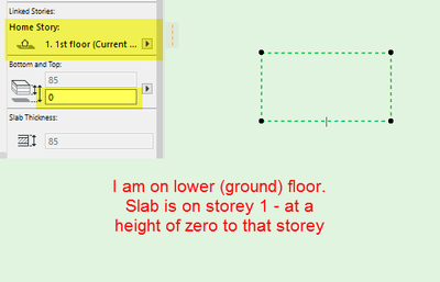

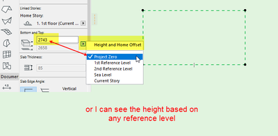

  14. When a slab is shown on other stories you can no longer click on it to see what its elevation is

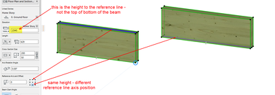

  18.  Used to be when I clicked on a beam it would give me the top and bottom elevations now it only gives me the top and I now have to do the math in my head to determine the bottom of the beam. Why is archiad making things harder

14.

18.

So that the beam moves up or down as beam reference axis changes from top to middle or bottom.
