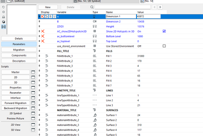

Is this what you mean by parameter list?
It doesn't generate in 3D so I can't adjust any of the parameters

Do you actually have a fill with the index 31000? Try manually setting the fills, then place a new instance of the object.
I tried manually setting the fills and changing the fill with index 31000 to something else. Still nothing in 3D.
