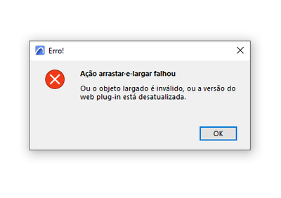

When I try to open the PLN with AC26, object is unavailable. If I try drag and drop, or Ctrl+C/Ctrl+V, it gives errors:
Ctrl+C/Ctrl+V, puts out 'Unknown version':
Drag and drop says object is invalid:
As far as I remember, .GSM objects weren't version-dependent until now, am I wrong?
Is there some simple config I might be missing?
(The object does not reference or 'call' any AC27 library object - In AC27 if I remove all libraries it remains intact)
2023-12-13 09:10 PM
Yes you are wrong. You cannot use an object saved with AC27 in previous versions.

It has always been that way. Until we got the new GDL editor, I used to maintain my objects in AC24 so they could be used with any version from 24 onward. For me the new editor is worth not being able to save backwards.

But here's what you can do. Open a new, blank AC27 file. place the library part inside of it and it will add it to your embedded library. Then save this file as a AC26 version. Select the option to save backwards compatible library parts. Open it in AC26, go to the Library Manager, then into the embedded library. From there you can extract the embedded part out to a .gsm file that will be AC26 compatible.

I performed the operation to verify it before posting it.
I created a 27 file from scratch, created an object out of two, criss-crossing walls and saved it in the embedded library. Saved the file "down" to 26. Opened the file in 26. The library part showed correctly in the plan window. I went to the Library Manager and saved out the embedded part as a .gsm to the desktop.
Hopefully it's a function that won't be lost someday.

I just did it again to be certain and it works 💯
