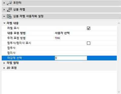

Hi
I have a problem with my skin label.
It has a parameter named "iselectfinish" for showing name of user select skin
and this parameter works usually well.

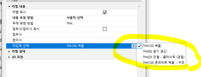

but if a wall has skins with the same thickness and name, it's not working.
When the wall doesn't have the same thickness and name, working good.
this is when it has skins with the same thickness and name on one wall.
this option tap is not working properly.

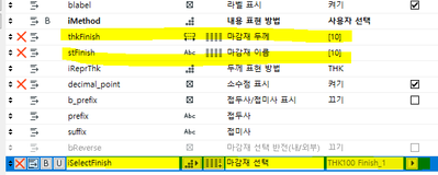

<PARAMETER>
dim _iSelectFinish[], _stSelectFinish[]
for i = 1 to numFinish
_iSelectFinish[i] = i
_stSelectFinish[i] = stSelectFinish[i]
next i
values{2} "iSelectFinish" _iSelectFinish, _stSelectFinish
I guess this problem come from "valuse{2}" but I couldn't find a way to improve it.
