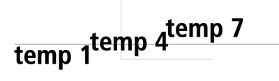

Hi!
I have noticed, that a simple text ( paragraph > textblock > richtext ) shows different results in mac, and windows platform. Here are the pictures from the issue:
the font is installed, but I tried with different font also - the result is the same
Thx for any hel
temp 1 - anchor point = 1
temp 4 - anchor point = 4
temp 7 - anchor point = 7
macmacwimwim
paragraph "temp1" 1, 0, 0, 0, 0, 0
pen penText
set style basicFont_bold
'temp 1 '
endparagraph
textblock "temp1" 0, 1, 0, 1, 1, 0, "temp1"
paragraph "temp7" 1, 0, 0, 0, 0, 0
pen penText
'temp 7 '
endparagraph
textblock "temp7" 0, 7, 0, 1, 1, 0, "temp7"
paragraph "temp4" 1, 0, 0, 0, 0, 0
pen penText
'temp 4 '
endparagraph
textblock "temp4" 0, 4, 0, 1, 1, 0, "temp4"
add2 1, 1
line2 0, 0 , 10, 0
richtext2 0, 0, "temp1"
add2 1, 0
richtext2 0, 0, "temp4"
add2 1, 0
richtext2 0, 0, "temp7"
del 3

Try  increasing the line_spacing parameter  of the paragraphs

szabadi_gergely
thx very much
