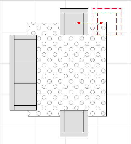

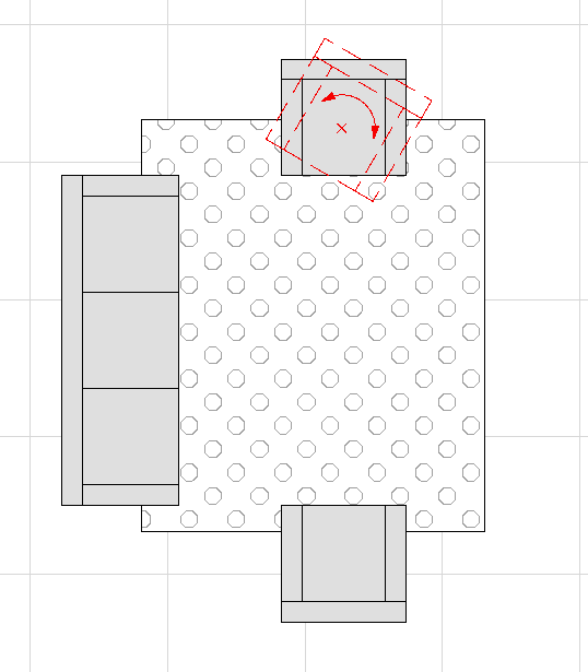

Hello all,
I have recently started out with GDL scripting and try to improve step by step by editing a general collection of 2D furniture objects. So far I managed to work with simple commands like Glob Scale and different varients of the "IF" command.
The next step would be to modify my objects so it is possible to move and rotate different components via hotspots. I added two screnshots to clarify what my intentions are.
Can anyone hint me to some pointers or commands on how to achieve these modifications?
Many thanks in advance.

ok, what you need to do is create a variable of distance in parameter for example "movex" then add a line in the script before draw the object something like "add2 movex,0" , and create the hotspot dynamic (pink one) to move it on the screen
hotspot2 0,0,1,movex, 1+128  !1 is for base point and 128 is for hide it
hotspot2 -1,0,2,movex,3 !3 this reference create a vector always oposite where you will move
hotspot2 movex,0,3,movex,2  !is will be the pink dot

for rotation create a angle variable in Parameters with the name turnZ
hotspot2 0,0,4,turnZ,6+128        !this is the rotation center hide
hotspot2 1,0,5,turnZ, 4               !this is base point where star your rotation
hotspot2 0.9*cos(turnZ), 0.9*sin(turnZ),6,turnZ,5    !this is the moving angle
