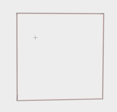

this looks like this :

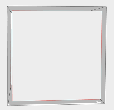

When changing setting space to 50 mm in the custom settings. The case will look like this.
Love this method once placed using de Solid Element Operator.
And that's it. You can change the case without having to change any other objects.
