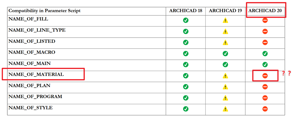

Can I ask a question about "Name of material", the manual said it does not compatible with ac
20 above??

That is if you try to request the name of the material in the parameter or master scripts.
But if you request it in the 2D or 3D scripts, it should be fine.

I see, thank you!😀
