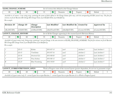

dim issuescheme[][]
issuescheme =GLOB_ISSUE_SCHEME
text2 0,0,issuescheme[2][7]

You can download an example object here https://gdl.Graphisoft.com/tips-and-tricks/revision-data-in-gdl

That's what I'm after.  Thanks AllanP & Yves.
