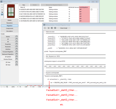

So you have a 'Generic' library with objects that you want to replace by migrating them to new objects?
This is what I do.
I create the new objects with the forward migration script that will set new parameters based on old settings if need be.
The correct GUIDs are required for the migration.
The auto migrate switch is off.
I then create a new 'Generic' library that has the new objects in it and the old objects have been deleted completely.
Archicad then detects the objects are missing and the migration scripts come into play replacing them with the new objects.
There is no need then to use the 'Migration' button in the Library Manager.
That I believe is only needed if you want to migrate for one library to the next, to the next, to the next and your migrated object only replaces the one version before it.
I just list all of the GUIDs for the old objects in the new one, so they all get replaced if they are missing.
Still the same.
If I uncheck the AutoMigrate checkbox, when I remove the original libpart (while the new one being loaded) the migration will not occur. If I check AutoMigrate, the migration will occur (but without FWM script being executed).
Dunno what the difference is.
GDL/Python/C++ dev
Make sure the GSID of the new object is not in the list of GSID to migrate.
Only the GSIDs of the old parts that are no longer in your library must be in that list.
As you can see in my image the '_endID' is not in the list of objects to be migrated.
The migrate button is only a shortcut to change libraries in the library manager. It detects previous versions' Archicad libraries, unloads them, and adds the current and the migration libraries. It doesn't explicitly start the migration process.
The migration process is run when library parts become missing (library reload, hotlink or copy-paste from another file). If there are loaded library parts whose migration table refer to a missing library GUID, the FWM script will be run.
