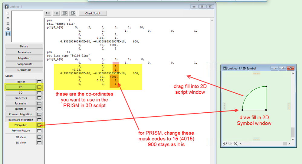

I'm trying to make an extrude of a quarter of a circle. What should I do?

If you want it as shown in your image then I would just use one of the PRISM commands.
EXTRUDE is similar, but allows you to move the top and bottom surfaces so they are not directly opposite each other - basically a slanting or leaning prism.

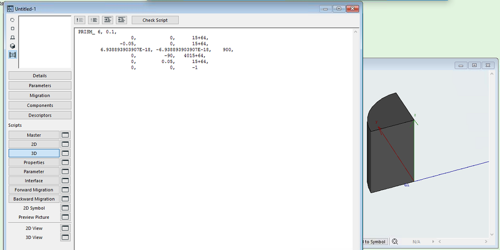

Do what I do if you don't want to figure out the code for a polygon/prism - cheat.
Draw the fill you want in an object 2D Symbol window (minimise that window so it is floating).
Select the fill and drag (CTRL+D) it into the 2D script.
This will give you the script for that fill.
It may give you 2 polygon scripts (one is the perimeter with no fill and one is the fill with no perimeter).
It doesn't matter, you just want the code for the nodes.
Copy them and use them for your PRISM command in 3D script.
Just change the mask codes to 15 instead of 1, so you can see the PRISM edges.
Or better still 15+64, so you see the edge of the curved surface from any angle.
You should end up with something like this.
