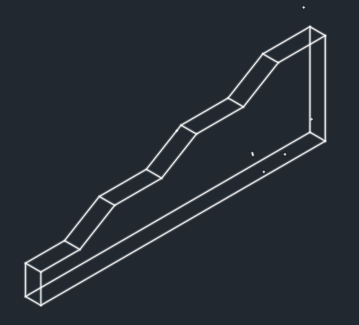

I want to make something like this with a command like Tube that goes to Path instead of prism.
I want to make something like this with a command like Tube that goes to Path instead of prism. Which commands should I study?

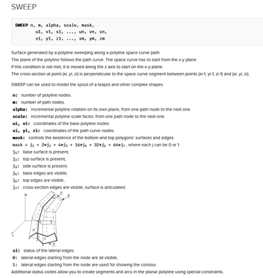

the tube command
TUBE    number_of_profile_nodes,   Number_of_path_nodes,   Mask,
             (Coordinates_of_profile  x,y,status)
             (Coordinates_of_path    x,y,z,angle)
https://gdl.graphisoft.com/reference-guide/shapes-generated-from-polylines#TUBE_gdlcommand
Remember
for the path the 1st Coordinate is invisible, the shape starts on the second,
and
the last Coordinates of the path is invisible, the shape ends on the second to last,
so
you require at least 4 path points for a shape.
or sweep
or tube a with scaling
