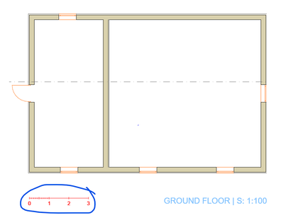

Hi to everyone,
I am designing a title object with "scale symbol" for drawings. I need <drawingscale> value for make this "scale symbol".
<drawingscale> is one of autotext. So, are autotexts number or string? Or not both?
If I can use <drawingscale> value as a number (or string) I can draw scale symbol. But I couldn't do that because -I guess- autotexts are not return a number or a string.
What can I do?

1 ACCEPTED SOLUTION
Solution
Yves
It is possible by creating two variables :
AC_OriginalDrawingScale (Text) and AC_Magnification (Real number)
Here is the script of my object

I am not sure how to explain this properly, but here goes.
Autotext values are nothing - neither string or number.
The <autotext> is just some kind of place-holder that can display the value of the autotext field, but does not actually convert the value into a usable string or number.
So you can display the value, but you can not use it.

@adura It looks like @Yves has probably given you a solution, but for reference there is also GLOB_SCALE which can be used in the drawing space to set the size of text and other objects to paper space sizes. It wouldn't be suitable for a title block referencing the drawing.
Thanks a lot for your reply/solution @Yves ... I will adapt your code to my own.

Thanks for your reply @DGSketcher.
I think GLOB_SCALE will not work here because the object will play on the layout.
