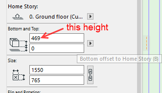

I have an object which spans multiple stories. If I stipulate a specific range e.g Home & One Storey Up or even All Stories it displays as expected. If I use the Show on Relevant Stories option the object display becomes limited to the Home Storey only. How does GDL determine if an object is "Relevant" to a storey view?

I am not sure, but is it anything to do with the height of the object - the ZZYZX parameter (not the elevation of the object).
Also in GDL there is 'ac_bottomlevel' and 'ac_toplevel' parameters.
I'm not sure if these play any part or not.

Well spotted @Barry Kelly . I am beginning to think the home offset & ZZYZX values are ignored by a Relevant Storey request and the "ac_...level" parameters need to be populated by the GDL code. I shall go investigate some more...
so if i set the ac bottom level to be less than or equal to ac top level then i get relevant display to work. doesnt seem to matter how tall or short ac top level is.

Easy as that. Just transfer the relevant lowest and highest values relative to the object origin into the ac_...level parameters.
The values can be anything you want, but to correctly display with the Relevant display setting the bottom value would match the lower limit of your object relevant to its origin and the top value the upper limit. The top value must be greater than the bottom value.

This parameter indicates the lowest point of the object. When Show on Stories is set to All Relevant Stories, if this lowest point (calculated from the object's home story settings) is contained in a story's vertical extension, the object is displayed on the story. Top level has to be above the bottom level. ac_bottomlevel starts from the object origin of the object.
ac_toplevel length
When Show on Stories is set to All Relevant Stories this parameter tells the top of the object. The object will be visible on a story if the story's height is between the bottomlevel and the toplevel. Top level has to be above the bottom level. ac_toplevel starts from the object origin of the object.
