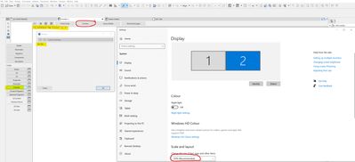

Long time user first time poster. In advanced, sorry if I have not posted this correctly, or if this has been covered already. I will welcome any feedback.
Not sure if anyone has noticed these 2 UI issues. If you;
- are using a PC,
- have high resolution screen,
- your display scale set to 150%,
- using Archicad 25 5010 and
- using script "UI_OUTFIELD "title" x, y, [width, height]", with "width" not defined for automatic width.
Then you will experience an issue where Archicad 25 starts cutting off your text, making it not readable.

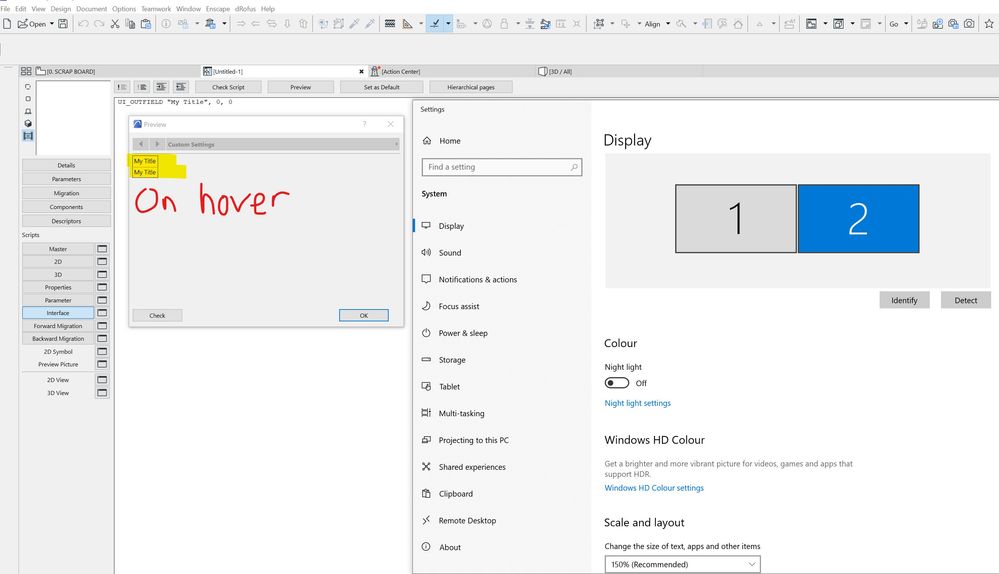

The second issue relates to when you have text cut off, the UI repeats the text content preview.

1 ACCEPTED SOLUTION
Solution
Peter Baksa
This is a known bug, also discussed in this topic: https://community.Graphisoft.com/t5/Developer-forum/Graphic-UI-Text-Bug-UI-OUTLINE-is-cut-short/m-p/...
It will be fixed in the next version (AC26).
Péter Baksa
Software Engineer, Library
Graphisoft SE, Budapest

Hi Péter,
Thanks for the info. Sorry for the re-post. Are there no plans to have this resolved in a hotfix for at least AC25?
Cheers,
Shaun.
Peter Baksa
No, there aren't.
