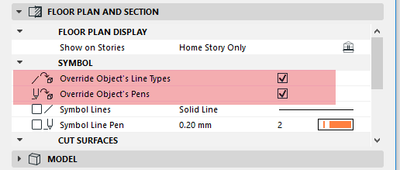

Archicad 24. Does anybody knows about some global settings or smth like this that controls behavour/pen represantion? Till now all my objects were working ok and they still do. But I got pln file from architect and only for that file I have issue with basicly all my objects (not standard obj, they work fine). To be precise - their line represantion (its colour).
It happens for 2D (only 2D script) and 3D objects (both scripts). No matter what pen I pick its always stay #1 (first one - black). I even tried to pick in object parametes #5 (blue) and override pen to #20 (red), but object remain to display pen #1. While I'm changing pen parameters at objects window, top and front preview shows how pen is changed, but after confirming (pressed OK) objects represantion remains the same. Though I found out that mine objects are not model element (for ex. inline MEP object) works as it should. But switching some objects to this type didn't in order to make them work has no effect.
Tbh I wouldn't notice this, if I didn't build 3D document from view. Changed this document represantion - all visible contour same pen: red. It did the job - all became red, except mine objects. They remain black.  If that would be happening in all AC24 projects I would understand that I made smth completely wrong. But all of these occurs only in that one file, meanwhile new created and all others AC24 projects don't have this issue. Objects made in AC22.

Have you got the pen over-ride active in some of the object settings?
If this is active it will not use the object pens and lines.
Pen override isn't active. More of that, if I activate it, it doesn't have any effect...

It was combination of reno filters and graphical override...
