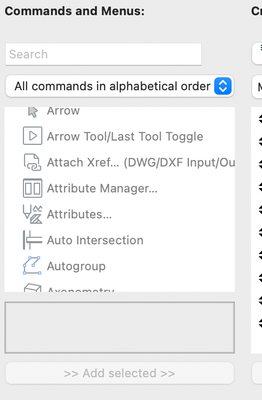

2022-07-29 05:34 PM
FYI,
The Arm version does not have the Original Attribute Manager it only has the new-UNUSABLE one. This should be in the notes.
On the other side of the coin, it is stable and "feels" snappier panning and zooming around.
another Moderator
2022-07-29 05:50 PM
It's weird that the 'old' Attribute Manager interface is missing as this is supposed to be. answer version with fixes. Could it be a Work Environment issue where the Attribute Manager has been omitted from the menu?
2022-07-29 06:06 PM
Still looking for it
26Arm
AC26 Intel Version
another Moderator
2022-07-29 11:11 PM - edited 2022-07-29 11:12 PM
Another regression bug in the new AttMan is that when importing attributes it does not add them to the last number but instead it looks for the first empty number. This was discussed to death during the Beta and it is back.
At least Reindexing is fast.
another Moderator
2022-07-30 10:40 AM
This is bad and definitely needs fixing before the final ARM release.
Not that I use a Mac, but all versions should behave exactly the same.
And it must create new attributes with a higher index number than all current attributes, not the next available one.
If next available number is used, attribute management will be impossible.
2022-08-01
11:58 AM
- last edited on
2022-08-01
10:32 PM
by
Thanks for reporting!
Yes, the tech preview version does not contain some last minute changes of AC26 but the release criteria for the final ARM version is that all functions, including attribute handling, should be identical across all platforms.

2022-07-30 01:43 PM
Yep, Have both and RC1 running without issues. Cannot use ARM version for work because of not having Attribute Manager.
