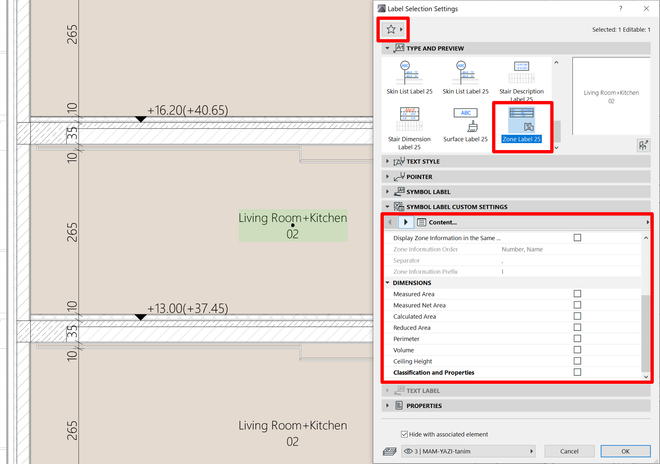

1. Zones appear in section and elevation views and can be labelled
Document zone-specific data on project views automatically and precisely with the new Zone Label — without manual workarounds.
Read more...
Thanks to this improvement, zones can be shown on sections, elevations, and interior elevations too. They are not only visible but also selectable and editable like other model elements. Zones can also be updated on section, elevation, interior elevation views and on 3D documents.
Zones can now be labeled just like other elements. Label placement can be automatic with the last click of the zone creation. You can add multiple labels to the same zone, for example for various views and scales. Labels are associative, thus follow the changes of the zone. Label placement, label interactions, zone preselection, and 'Label selected elements' command work like on any other elements.

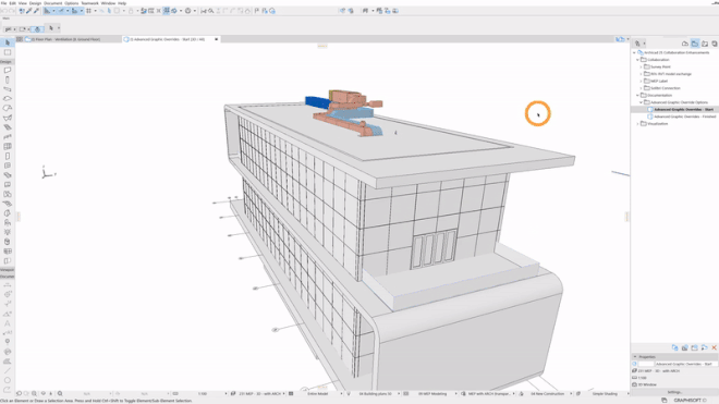

2. New Graphic Override options
Highlight any element with custom colors or contours. New controls in Graphic Overrides include custom RGB colors for both Surface and Fill Background Pen overrides; surface transparency; and on/off display of contours on cut and uncut surfaces in model views.
Transmittance slider for color overrides of surfaces
Read more...
Since the release of Archicad 25, you can select any RGB color in Graphic Override Rules to override surfaces and fill background pens. In Update 2, there is a new transparency control option, so you can adjust the transparency of the surface colors.
Show or hide cut and uncut model contours
Read more...
With this improvement, you can keep the contours of specific model elements visible while hiding those of all the others. This helps you draw the attention to the elements you want to emphasize.

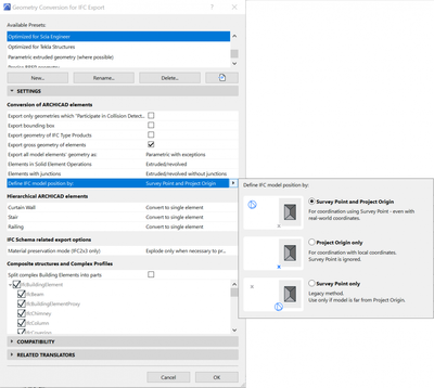

IFC Merge improvements
Read more...
When merging IFC files into Archicad 25 project files, you have the option to either use Archicad's own Project Origin or Archicad's native Survey Point as the insertion reference point. This gives you more control over the coordination process and you can choose the option that suits you best.
Define the point of reference to align the merged IFC file with:
You can also define how to position the IFC model when exporting:

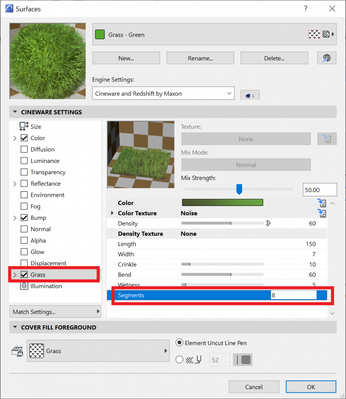

8. Grass Rendering enhancement
Get the right balance between rendering quality and speed!
Control the level of grass texture detail to achieve high quality renders for close-ups or reduce it for faster landscape renders.
Read more...
Control the level of detail grass should be rendered at. Faster rendering of grass is possible — in Grass Surface settings, use the new "Segments" field to limit blades of grass to speed up rendering.

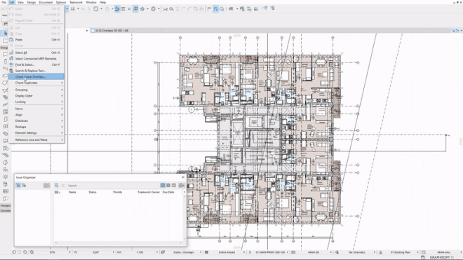

10. Check for partially overlapping linear elements - technology preview
Get high quality models with Archicad.
In addition to checking for duplicates and fully overlapping elements, Archicad can now check for partially overlapping model elements as well. Deliver models with full confidence using this Technology Preview feature!
Read more...
In Update 2, Archicad can check for elements (3D walls, columns, beams, and 2D lines, polylines, arcs, etc.) that are partially overlapping. Previously, Archicad (with the Check Duplicates addon) could only check for duplicated (fully overlapping) elements.
This new improvement is vital in the quality checking and assurance processes. Models will be clean, and all redundant elements can be easily identified and addressed.
The command is available at Edit > Check Linear Overlaps.
The results of the check are listed in Issue Organizer. After fixing an overlap, the corresponding issue disappears from Issue Organizer and Issue Manager.
Note: to access this feature first you need to enable it at Options > Work Environment > More Options > Experimental Features.

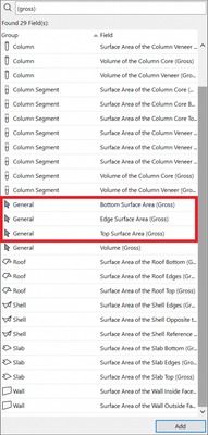

12. New General (Gross) Surface Area fields for scheduling
More options, more information.
Enhance your quantity take-offs with new schedulable parameters for more thorough documentation. Quantify the top, bottom, or side gross surface area of your project elements automatically.
Read more...
New general scheduling fields have been added including 'Top Surface Area (Gross)', 'Bottom Surface Area (Gross)' and 'Edge Surface (Gross)' that combine existing separate tool fields.

Marian Pristavu
Hi, I just wanted to ask, is the "check linear overlaps" function available already? I can't find it in Archicad on mac.
Thanks
Did you enable the experimental feature in your Work Environment?
Marian Pristavu
Thanks @Barry Kelly , this solved the problem.
