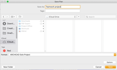

Backing up a teamwork project as a PLN file is easy!
When you work in your teamwork file, you simply go from the: Drop > Save menu as...
Next, you can give the file an appropriate name, select the desired storage location, and select the file format "Archicad Solo Project" (PLN file). Then you just click On Save.
If you would like to have the file you have saved on the BIMcloud for EDU server, you can simply re-share your project with your teammates. To see how to upload projects onto the BIMcloud for EDU server refer back to the "Get to know BIMcloud for EDU #2" article
