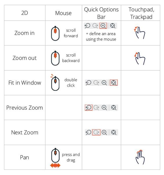

Here is a quick summary of the most often used navigation commands:
You need to learn to navigate in 2D, which means:
  • Panning: dragging and moving the content you see
  • Zooming
    • Zooming in and out - changing how close or far you are viewing your design from
    • Going back and forth between previous and next zooms
    • Fitting the entire content of the current view (floor plan, section, etc.) in the window - Fit in Window

  • Zooming using the middle button (wheel) of the mouse
  • Zooming using the trackpad
  • Zooming using the Quick Options Bar commands (and the mouse)

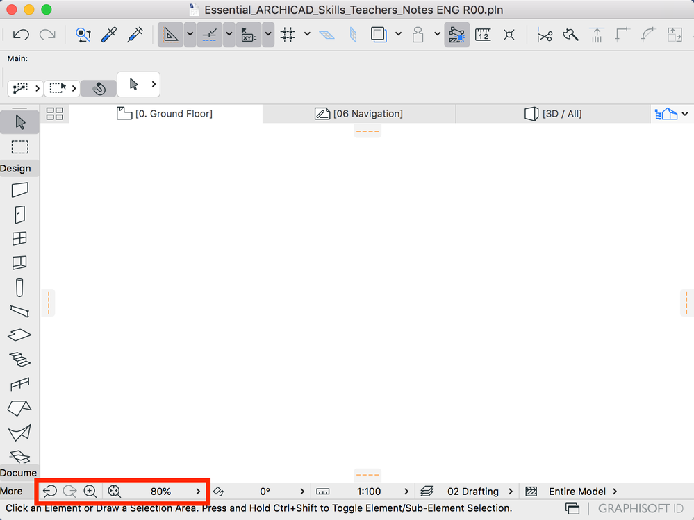

This is where the zoom options are located on the Quick Options Bar:

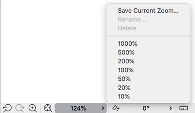

  • Previous Zoom and Next Zoom: these are to go back and forth in time to show the previous/following portions of the view content. 20 of them are stored.

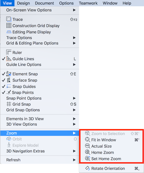

Read this User Guide to learn more about further zooming options, such as
Zoom to selection
You can zoom in to the elements you selected by right click on anywhere while selecting your elements and choose Zoom to selection.
