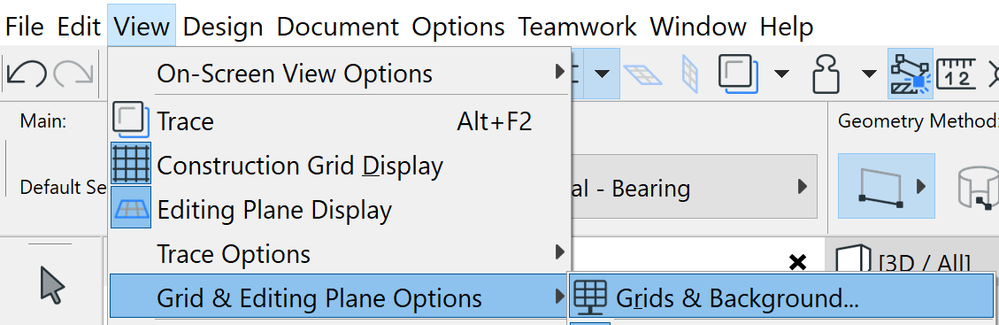

Using them is optional, you can work in Archicad without using any grid, but in specific circumstances, they are very useful. Settings are available at View > Grid & Editing Plane Options > Grids & Background.

The Construction Grid is hidden by default. You can turn it on these two ways:
Use the menu command at View › Construction Grid Display or use the same command, also available on the Standard Toolbar:
