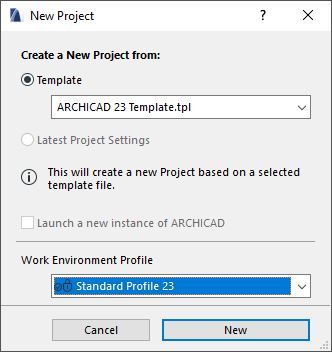

The Start Archicad dialog pops up:
The Start Archicad dialog box offers you the possibility to:
  • Start a new project (New...)
  • Open an existing project (Browse...)
  • Open/join a Teamwork Project (Teamwork...)
You can also access sample projects and training materials from the startup dialog of Archicad by clicking on the button marked in red on the image above.

Assuming you are new to Archicad, we now go on with starting a new project. Hit the button New...
